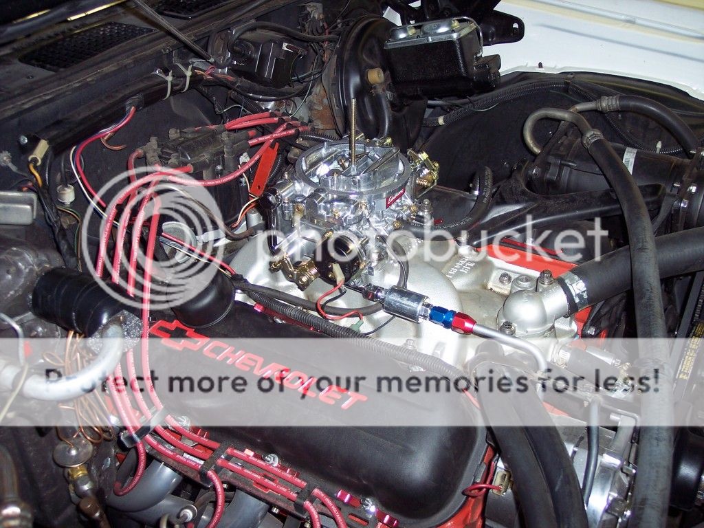

Replaced Eddey Carb with new Eddy 1406 Carb. Throttle Return Spring interfered with chock linkage, replaced return spring & minor adjustments and done! grin
Hard plumbed my Fuel Delivery system from Fuel Pump to Carb. Had to form a new hard line from pump to new fuel filter. Also added a Banjo Eddy fuel line from Carb to complete hard plumbing. May have a vapor lock issue, not sure yet. Went to gas station, filled her up and then when ready to leave acted like Carb wasn't getting fuel. At first I thought Carb was flooded but after pumping pedal while cranking she finally started and ran just fine up to the garage where I parked her last night. Probably next week end before I will have time to investigate further. confused
Before & after pic's of fuel deivery with new carb:
Doug when I replaced my Holley with a 1406 I started have fuel problems on my 72. The fuel pump was bleeding off/back or whatever. Replace the pump and it starts on the first try now. I really had to crank it over for longer than I liked to get he fuel back to the carb.

Doug, it looks really sweet !!! I plan doing the pretty the same fuel delivery system as soon as I got my new Carb / Intake wink
