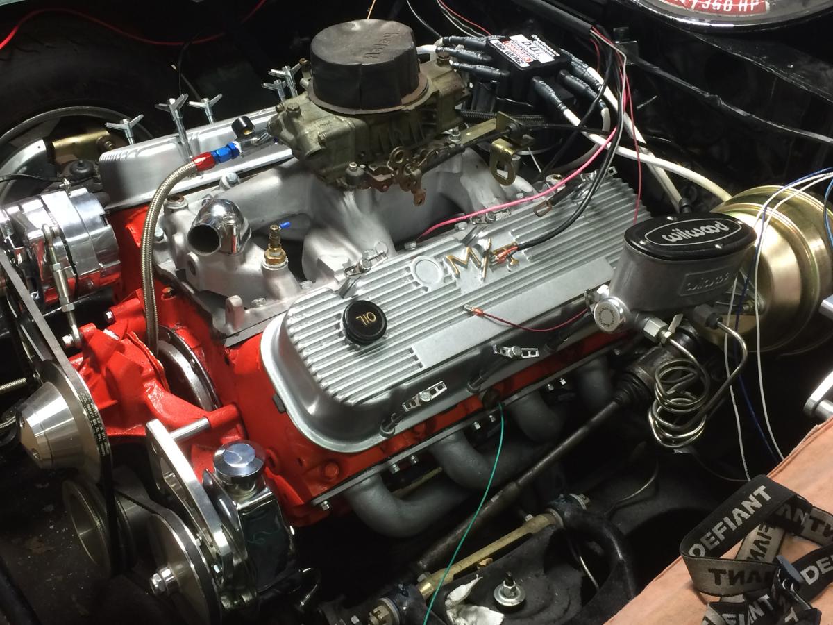

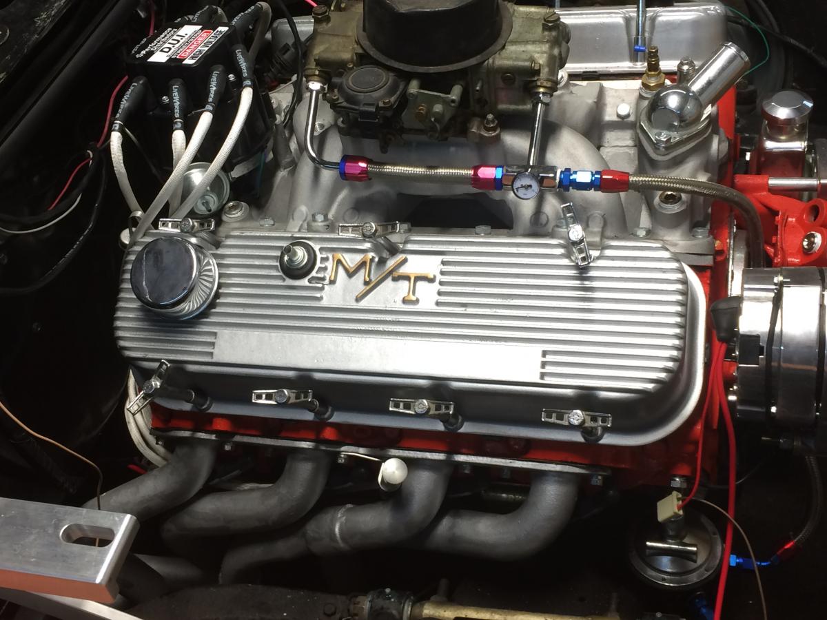

No doubt after 14 years without turning the engine, my valve springs are done. This Moroso tool made things easy-although a bit difficult to attach at the rear locations.
AND as my machinist is an anal SOB (thank heavens!) I need to measure the static height of every valve stem so he can get the spring pressures and shims "dead on balls accurate". This engine has a mechanical roller cam with .680 lift, the springs need to be accurate. What a pain doing all this in the car!
