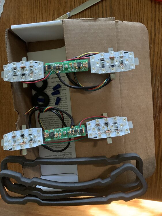

My new led tail lights arrive today… It took about two weeks,  but I think they are worth the wait…    Will update after install …  IMG_2219.thumb.JPG.9facfce61867975a1b65a325ecf95850.JPG
I think you'll be pleased with the outcome.

Forgot to add this in my comments, hope you got the pig tails so its really plug and play. There is a thread on this also

Gottem… Plan to install as soon as I finish the bad valve guide on # 4…   I have the head back on…  long story ..

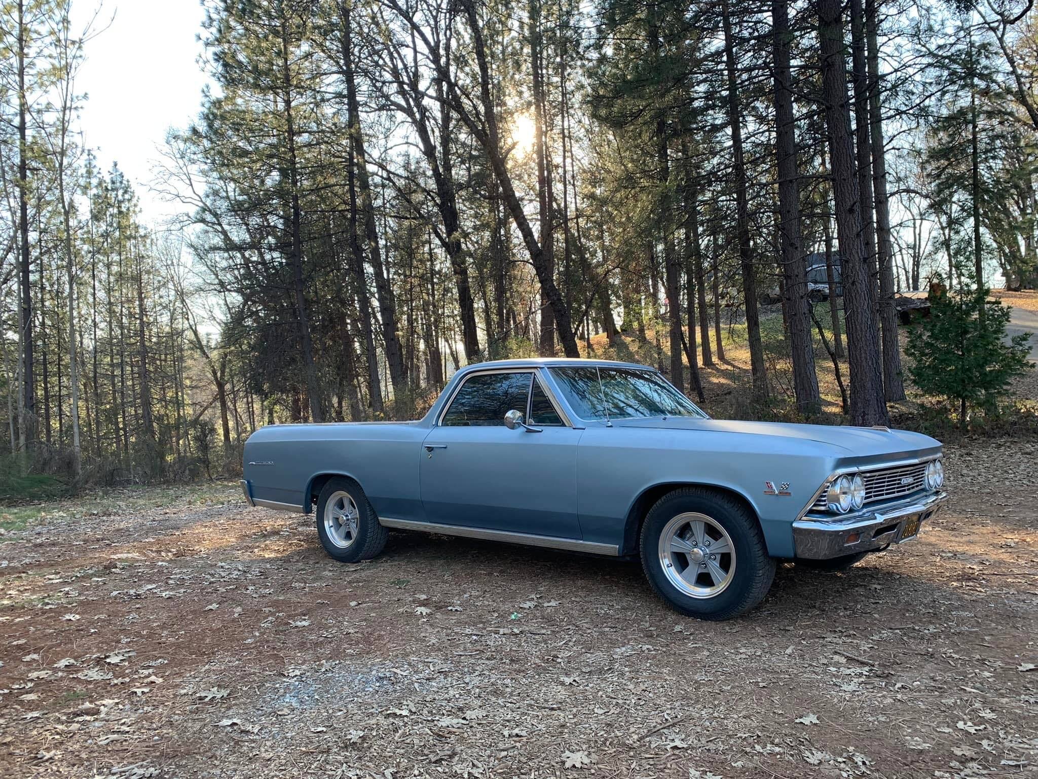

Went with my Daughter to pick up her new '66 El Camino …
Has a big block 454 with 308 gearing … Done right,,, but needs detail work …. She wants to do the work herself…  Awesome Daughter, Awesome truck…

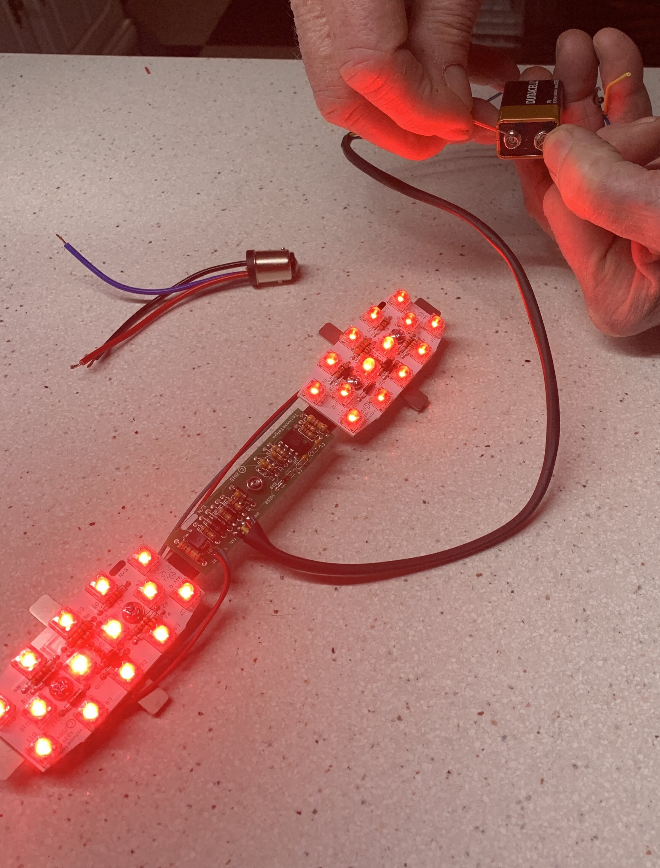

Tested new lights …..  used a 9 volt battery, connect the green wire to the negative and red or black to the positive …. Don't do this with the car battery…..
Testing LED lights for proper polarity with a 9v battery is also a great way of determining which wires are positive and which are negative. For example, if you have a three wire LED light assembly, touch the suspected negative(-) wire to the 9v battery negative(-) side and at the same time, touch the one of the remaining wires to the 9v battery positive(+) side. If by chance you’re mistaken and end up with both positive wires connected to the 9v battery (LED + to 9v(-) and LED+ to 9v(+) ) no damage should occur.

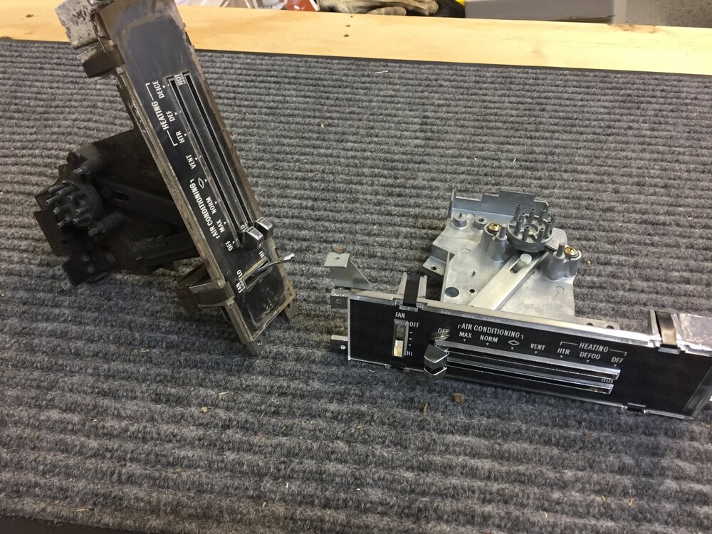

Thought I posted this earlier today, but it hasn’t shown up... Replaced the heater / AC selector switch assembly in the dash . Was quite an ordeal.. not the best position to work in. But I managed. Will need to replace couple vacuum modules also, which could be even more difficult... we shall see/ eventually...8408696E-D46D-4037-B908-EFF388EC844D.thumb.jpeg.c792dd024bb29ed5b9607b86a3f1d89c.jpeg
